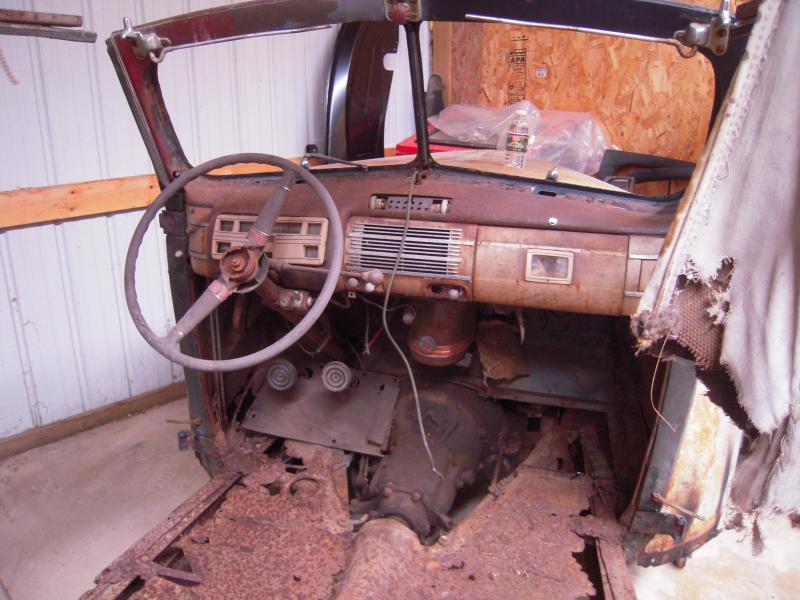

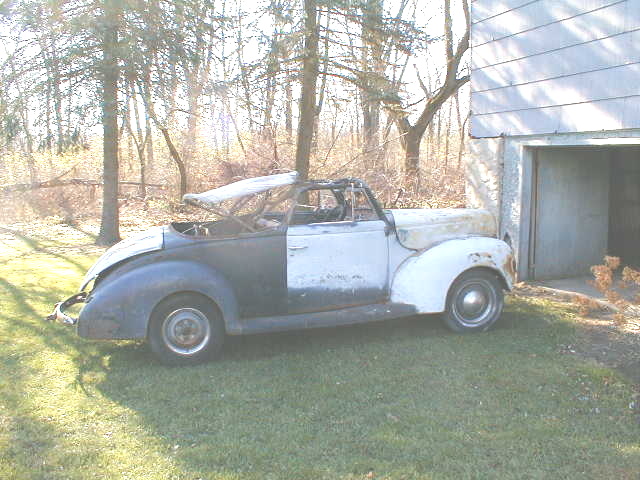

Attached herein are photos of the vehicle upon purchase. I know, I know... "What was I thinking?"

My God, you are really gonna have to get-on with some of that "anal-ness" I spoke about earlier to pull this one off, Kube. Just where in the heck do ya start with a mess like that? I'm kind'a convinced from your past performances that there's probably no doubt, you'll pull this one off just fine. DD

The actual car looks pretty straight and original.
With a new floor installed it would be half-way there.
Good luck.

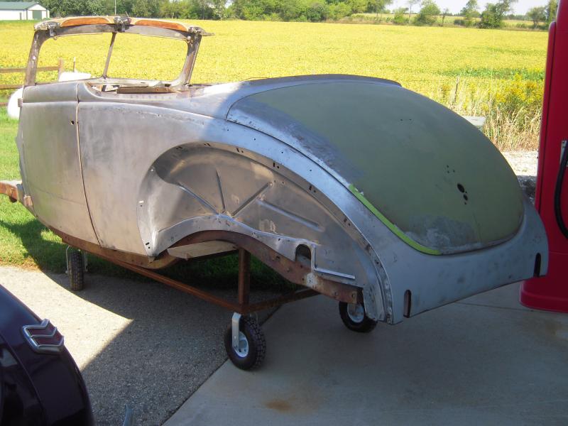

V8coopman, and SwoopNZ, Believe me, there have been PLENTY of times in the past nine years I have asked myself "Self, WTF were you thinking"? The answer nearly always came back very much not to my liking.
To kind of play "catch up" on this project I can tell all that nearly everything related to this car sans the body and paint is done. Engine, trans, well, the entire drivetrain are done. Highly detailed and awaiting installation. The interior panels, seats, dash, moldings, etc. are done. Steering column, steering wheel... the list goes on and on. There are literally 22 boxes cataloged and stored in my basement along with all the items too large to box. ALL of it is done - detailed and ready to install.
Through the years, while restoring other cars, I have managed to spend a few hours here and there on sub-assemblies for this project.
In reality, there is very little to do other than the finish body and paint. The hood and fenders already have the guide coat on them. Once the body is where I want it, I'll get the fenders and hood aligned and blocked out.
Oh, the frame still needs to be restored. I'll get that done before any paint work on the body.
The photos attached herein depict pretty much where the body currently is at.
