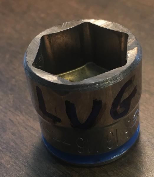

I went to the local auto parts store and bought a cheapo socket.
I put both the socket and the end of the crank handle (in case I need it on the road) to the grinder. When I mount the socket or the crank handle on a lug they are about 1/8 of an inch off the wheel, but still plenty of bite remaining. |
