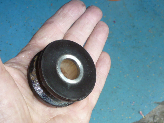

Hi Bill,
I turned a considerably smaller pulley for the alternator. (Oak wood with steel disc insert.)
So I already have plenty battery charging current at idle speed.

Yes, a smaller pulley will turn the alternator faster at idle so that its output starts sooner and is a little higher. Rember your "A" idles probably around 400-500 rpm and the modern car that your alternator came from would idle around 800-850 rpm.
