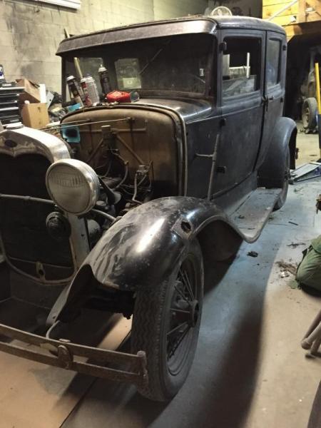

Hi everyone. I have a 31 fordor blindback. I would like some information on it if anyone could help I would greatly appreciate it. The body number is 167-8087 and the engine number is A4686988. Any info would be very helpful. Thanks Ken

Let's see now:
If the engine is the original engine that was put into the chassis of this car when it came down the assembly line and if the engine is not a restamp, then it was stamped at Dearborn on May 26, 1931 but it does not tell you when the car was built. To see if it is the original engine number, you will have to remove the body and view the stamping on the frame if still ledgable.
Next, does it have an assembly code? Go here to review just where you may find the assembly code on your body: http://www.plucks329s.org/pdf/studie...ND%20CODES.pdf
Your car has no indenteded firewall...this appeared in May 1931 so my gues yours would maybe be an early May 1931 or earlier right before the indented firewall came into the picture.
You can also purchase the MARC/MAFCA Restoration Guidelines and Judging Standards which will help you key ou the rest of the car to try to determine an aprox. build date.
Looks like it will be a nice restoration...just do not get discouraged!

The radiator shell and the running board splash apron lead me to think that this car is a 1930 not a 1931. Am I wrong??

Some of the early 31 Fordors did not have a slant windshield. I am not sure when the change over happened, so yes, it could be an early 31.

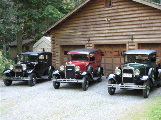

Here is an Aug 1930. As above rad shell 30? and I have 29 bumper I like it! Delux Blindback.Nice project!

I agree.

very interesting is the hole in the fender and the small pipe coming up from the front fender? Something mounted there or inspection hole for the tire.
Did all the front fenders have the seam inboard on 31's? I have a S/W.
nice project coming up.

with the split splash apron,it can only be a 30

That particular engine number was stamped on the engine that was dropped into the chassis on June 27, 1930.
So maybe a July 1930 assembly???
Review my frame data and compair it to your frame to try to get a more exact window of assembly.
